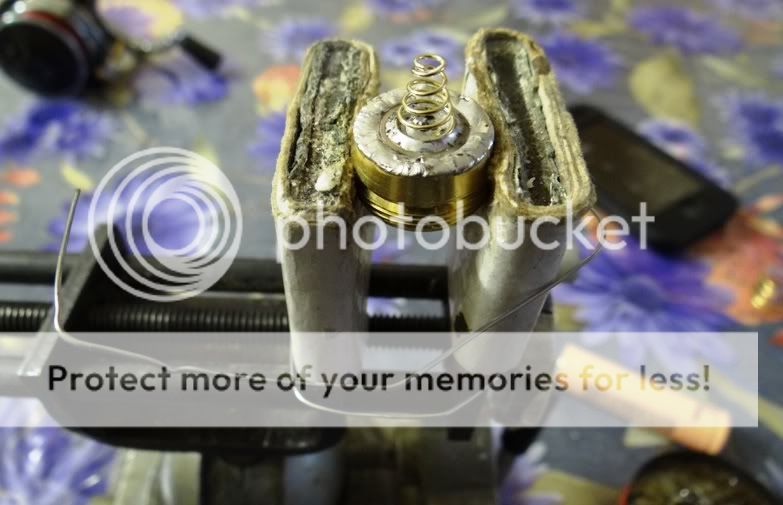

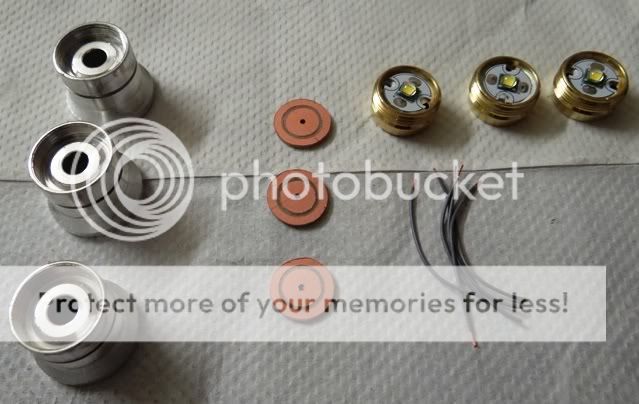

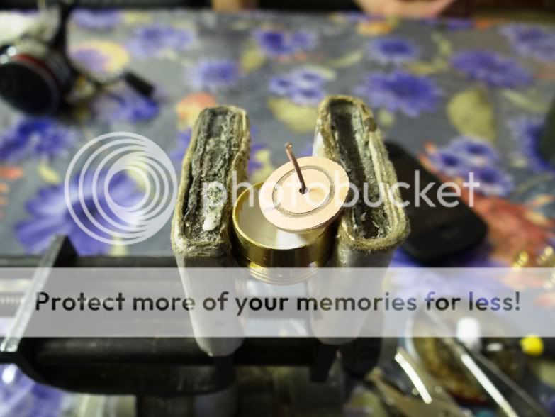

This kind of comparison dosnt exist because of the nature of drop ins. You have to realize that most drop ins are made to order from a few different people. Drop ins were never really mass produced. So people just went to the people making them and said I want XXX and that is what they got. If you go to Nailbender, AKA Dave and tell him what you want, he makes it.
What happened is Lego'd SFs got to popular that flashlight E stores started having these builders build them X amount of drop ins in X amount of configurations. That is where you get nailbender drop ins from places like lighthound.com.
The Pill is what the LED and driver go into. Its usually made of brass. It is also what the reflector screws into.
Reflectors on left, pills with LEDs installed on upper right.
Here is another one, from L to R, Spring, Spring, Pill, reflector, drop in all put together.
Potting explained below.
This is the link to nailbenders drop in page. Im going to break everything down for you guys by taking one of the many LEDs that he offers and showing you how you would order. We are going to use the XML since it is THEE hot LED to have right now. Heres the thread : http://www.candlepowerforums.com/vb/sho ... I-(part-10" onclick="window.open(this.href);return false;)
Here is a cut and past of the order section for the XML. All of my stuff is in RED for explanation.
CREE LEDS http://www.cree.com/products/xlamp.asp" onclick="window.open(this.href);return false; binning and tint informaiton (GREAT RESOURCE)
Cree XM-L $40
This section below is for the color tint of the LED. the flux bin and number (I.E. 5400K) refers the how warm, neutral or cool the LED is. Here is a great picture to better explain color temps.
The cooler the LED is, the brighter it gets in lumens. The problem is, the cooler it gets, the more blue everything gets. Nuetral LEDs are best when color rendition is top priority. Then the warmer you get the more yellow the beam gets. This all comes down to personal preference. I love 5400K tinted LEDs.
U2 flux bin 1A 6500k+ Cool White
T60 flux bin 3C 5000k daylight white
T50 flux Bin 4C 4300K neutral white
T40 flux bin 5B3 4000k neutral white
T40 flux bin 6A3 3500k Warm white
T30 flux bin E7 3000K Warm White
This section has to do with power. The first option is direct drive. These have no regulators and it is a direct connection to the battery. This is really only good for enthusiasts that know what they are doing because you can really burn skin and blow up batteries if you dont know what you are doing.
Direct drive
1 Level only (potting and tape included this model only) works well in the 26650 Cooly's by Five Mega.
Here is where it gets most confusing for folks that dont have a background in electronics. Levels are self explanatory, Amps are going to effect the brightness and how hot the LED gets, volts is going to determine what kind of battery configuration can be ran.
****This guy did a great job taking some of the most popular LEDs out right now and recording the lumen out put ad different amps. This is a great guide if you just know how many lumens you want but dont know how many amps to get you there. Just look up the the output you want and see the corresponding amperage at which it was achieved:
http://budgetlightforum.com/node/2603" onclick="window.open(this.href);return false;
3 level / 2.8 amp /3.4 - 9 volts (high / med / low with memory ) NEW!!! $45 Best used with 2X Li ion or 2X primaries
Available levels with memory (2.8-6 volts only)
1 level Regulated
2 level HI / Low Regulated
3 level Low / Med / High Regulated
3 level Hi / Low / Strobe Regulated (rotation of levels may change between driver batches)
5 level Low / Med / High / SOS / Strobe Regulated
6 volt Drivers can be pushed at 3.1 amps and 3.5 amps or even 4.2 amps but high should be used for shorter periods these do work well in the 26650 Cooly's by Five Mega.
and in 2P 18650 P60 M*g 1D by Fivemega There is no extra charge for these.
If you want to use continuously on high in most hosts please use 2.8 amps for better heat control and you will also get much better runtime.
Here is the option for reflectors. Smooth reflectors give you more throw but sometimes have some artifacts in the beam. This is my reflector of choice. OP or orange peel reflectors give more spill and usually have a perfectly round, nice looking beam. Most off the shelf configurations come with an OP reflector.
Either Smooth OR Op reflectors available (extra reflectors not available at this time.)
This section is the section Freeze asked about. Potting is when you fill the pill with a thermal conductor. This just pulls heat away from the LED. Here is a picture of the bottom of a direct drive pill/drop in that is getting thermal potting:
The copper tape is so that you can wrap the pill and relfector so it has a tight fit with the drop in. This again all has to do with getting the heat as far away from the LED as possible. Here is a video from Wayne showing how to wrap a drop in only he uses aluminum foil. Foil can be used if need by. I prefer 99.9% pure copper tape. This way you get the best heat transfer available.
Potting with copper tape is now included
So that is the basic break down of the sales thread for the XML portion. So lets apply it. Lets say I want around 700 lumens on high and I want to run it on 2 primaries. We can look at our chart from the link above and see that 700 lumens comes in at around 2.2a based off the chart. So you want a 2.2amp driver. Next is voltage range. You want to get as close to the voltage you will be using in your drop in. Too low of voltage and the drop in wont work. Too high and it will burn up the LED. So in this case if we are planning on using 2 cr123 primaries we need something rated at 6V. As you can see, Dave offers up to 9 volt drivers. But you my ask, why dont I just get 9 volt drivers and that way im covered with all batteries? Good question grasshoppper. The closer you are to the voltage with your batteries as you are to your driver the more efficient the driver will be. So it is really worth it to get the right driver for your batteries instead of just getting a board that has a HUGE voltage range.
I Ripped a lot of pictures off for this post. Considering I am giving shout outs to all these builders and not getting a dime, I hope they are cool with me using some of there pics. Again, shout outs for the pics and awesome builders, Dave, Wayne, etc.
Feel free to ask more questions. there comes a point where I have to stop or else I can keep going....
