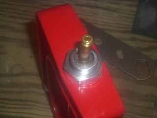

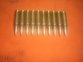

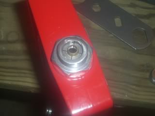

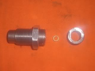

I'm here guys, sorry took me a wile. But here it goes:
you can use a .223 die, if you cut portion of it from the top. It is allso nesessory to use a bushing to controll the thickness of the crimp and to keep it uniform.
Here some picktures:

On my regular Lee dies, the instructions say to back-off 1/4 turn if u dont want a crimp and to turn down 1/2 turn if you do want a crimp. What kind of a job will the regular dies do? If I dont turn it either way, will the die still make a weak crimp?
VITALIY
Posts: 336
Joined: 21 Aug 2008, 20:22
Location: NW subburbs Chicago
Re: Crimping the 5.7x28mm
Post by VITALIY » 30 Aug 2008, 16:05
Grantness wrote:Thanks VITALIY. Thats really cool.
Sir, you're welcome.
The regular roll crimp on yor sitting die will do you no good at all, couse you must use only the bullets with canelure for crimping. On the other hand modified .223 factory crimp die will crimp any bullet. Yes it will add one more step to your loading proceadure, but it is well worth it IMHO.

do u have the specs for that bushing?
LK45s
Posts: 709
Joined: 20 Aug 2008, 10:47
Location: Iowa
Post by LK45s » 31 Aug 2008, 17:44
I believe in the original post he said he cut off a piece from an old gun rod. Another member said he used a faucet washer. I guess the main thing is that it is thick enough to get a light crimp.

Post by Grantness » 01 Sep 2008, 17:12
I was able to successfully apply a roll crimp using my Lee bullet seating die to the 45gr Barnes TSX and Banded Solids... It works great. I tested one on an unprimed case first, and was not even able to push the bullet into the case using a hammer :D
