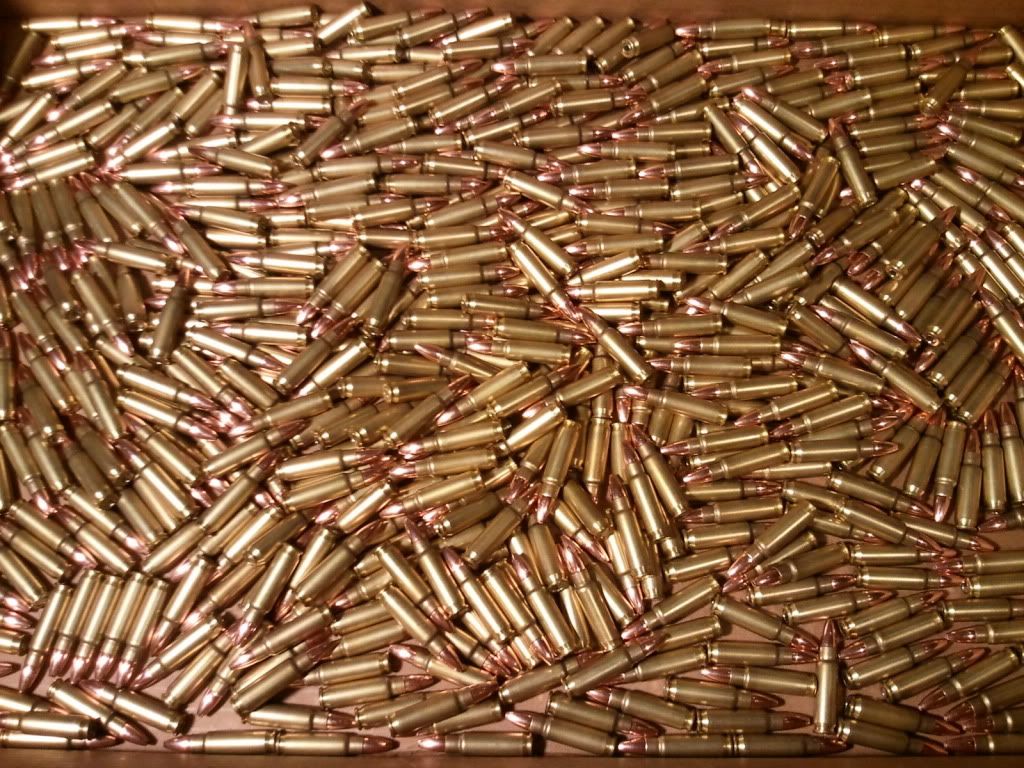

I have loaded thousands of them for the PS90. They work just fine.

Heres a pic (although these are the VNE bullets - basically the same)
