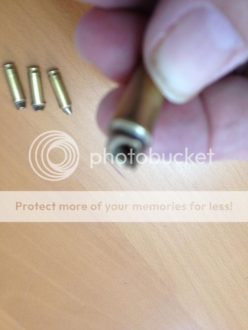

I went to the range with my new FsN and a newly built out AR57 built on a PSA M4 lower, PSA Premium LPK, brand new AR57 Gen.2 upper, and 3 FN 50 round mags. Took 500 rounds of 40 grain AE ammo. The pistol shot 300 of the rounds flawlessly and was a pleasure to shoot. The AR57 was a PITA...there were at least four rounds where the round appears to have been slammed by the bolt and had the projectile pushed into the case...in each instance there was an FTF...and more than merely pushing the projectile in the cartridge necks were smashed....pretty badly....see photos below.....it seems that everyone is saying that they don't have the issue with hotter ammo. I have loaded a bunch of my own rounds, but really don't think its too bright to shoot reloads until I can conclude whether the issue is the rifle or the rounds.....thoughts appreciated.

The mags are ALL FN Factory Mags...no copies...the lower and the LPK are the Premium PSA....the upper is a 2nd Gen. AR57 center. ...all I tried was the AE....I have SS192..but won't try that until I figure out if there is an issue with the bolt.....see pics below.....these didn't merely get pushed in they got the crap smacked out of them.

I had the same thing happen to about half of mine Beecher some were just jammed back into the casing others were totally destroyed like yours. From what I could tell is that the rounds were on the right track, but then stopped short by slamming into the frame with about half of the neck slamming into the entrance of the chamber causing the massive damage to the casing. And again it was only with the American Eagle rounds
