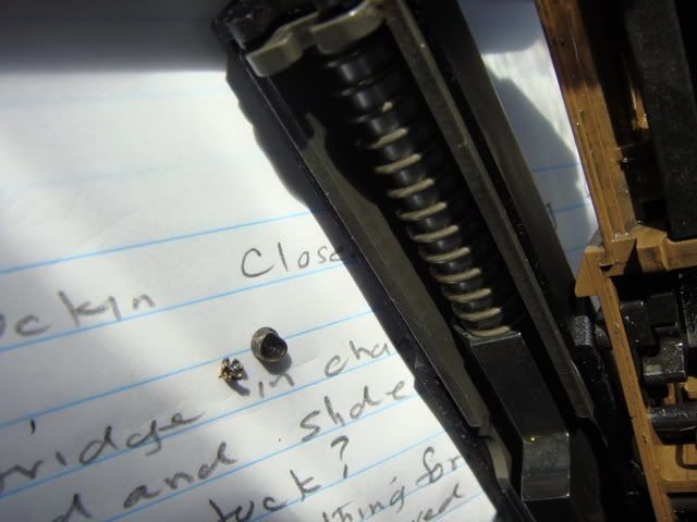

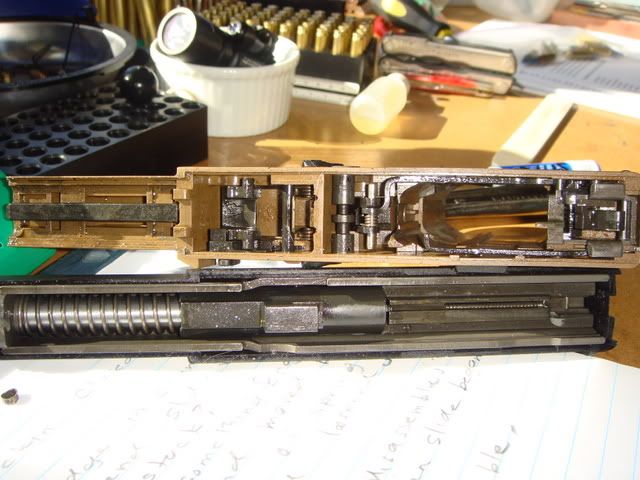

Thank you for the advice. Here is a picture of the gun.

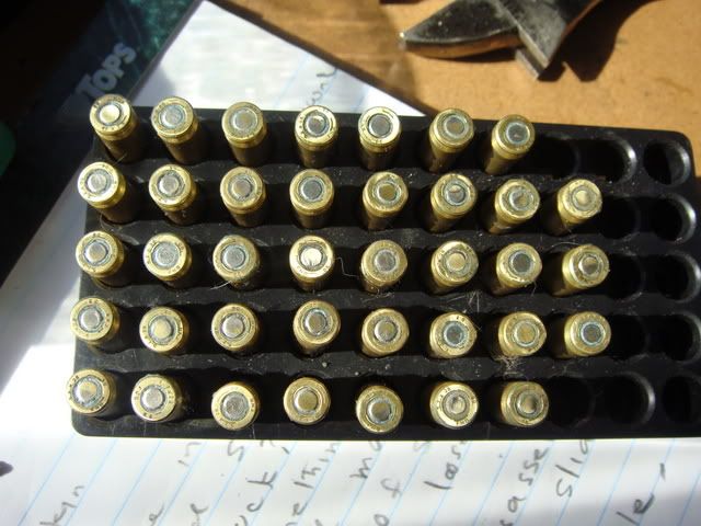

Turns out it was another primer jammed in the slide. A good strong pull and the slide moved enough to disassemble the pistol and two pieces of primer fell out. Blown out primers happen occasionally when shooting hand loaded cartridges. Has anyone had experience gluing primers? Here is a batch of brass with super glued primers for testing.
