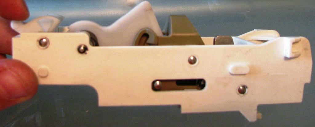

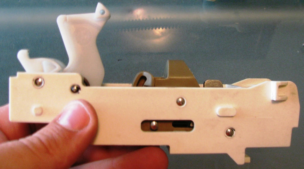

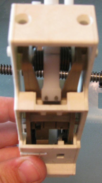

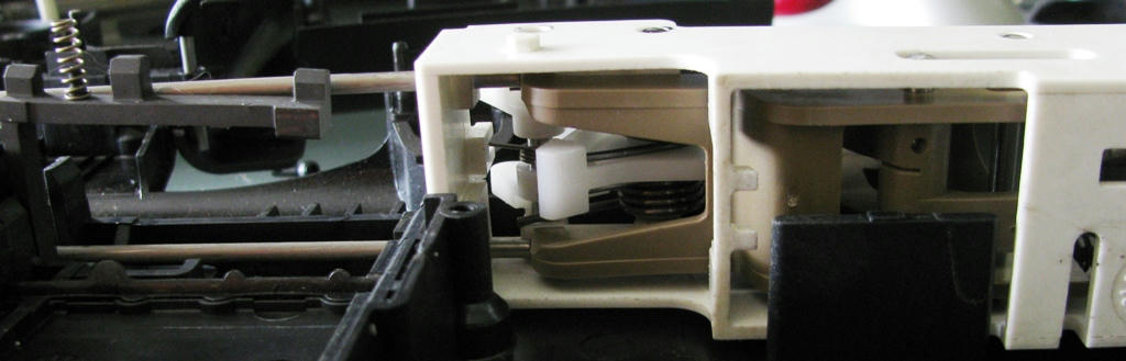

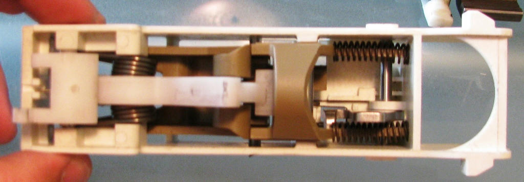

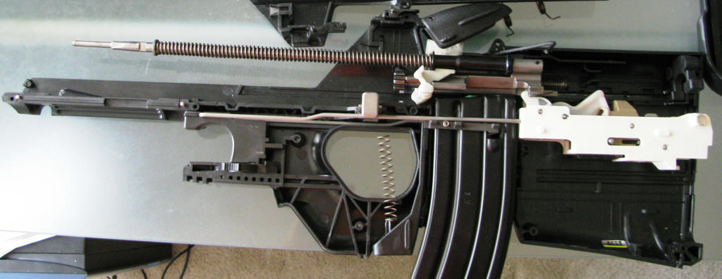

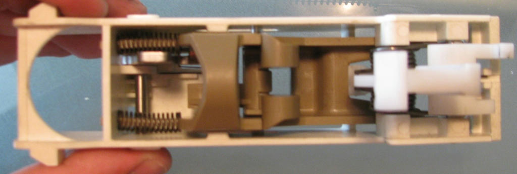

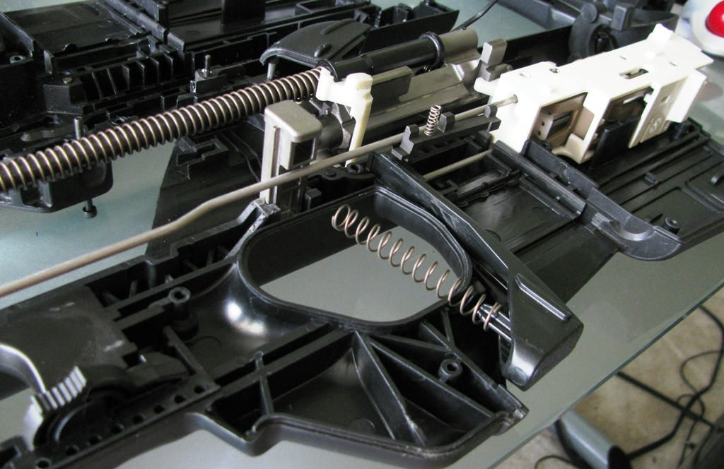

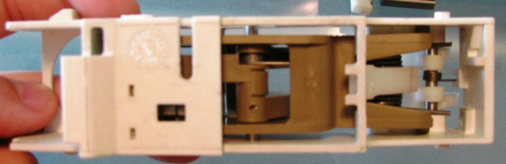

Just took a bunch of pics of my Fs2000 internals.. I'll see if I can figure out how to post 'em

Nice pictures. That might pretty simple to turn into a light two stage semi-automatic trigger. That would really increase the accuracy.

I have a product that has truely done wonders for the Steyr AUG and the FS2000 has a very similar hammer group. The result so far is 3/4 Lbs lighter trigger pull and significantly smoother pull. The part is called neu-trigger and can be found with a google search. On the AUG I've been able to lower the pull weight by 2+ Lbs. This can be installed permanently but removed at any time to go back to the stock configuration.
For those of you looking for a more permanent change, Look at cutting 2 or 3 coils from each trigger spring at the forward end. Cut one coil from each and test in between until you like the pull weight. Since these hammer groups are riveted together, there's only so much you can do.

There's nothing riveted in this hammer group....

So answer this. Can you push out the pivot pins or not? You sound certain that it has no rivets.
Those silver rods are the rivets.
Re: FS 2000 Trigger Pull
Yep... check the pics above... those are pins.. not rivets.
I'm not exactly sure how your mod would work... but there are at least 2 different (yet similar) hammer packs for the F2000... might require different mod kits.

If you look closely at the ends of the pins they have been flattened. These pins have been expanded at their ends so they can't be removed. Technically that makes them rivets. The pins on my part can't be removed.
The part I'm talking about fits the brown plastic sear seen in the above picture. If your sear is different then I would need to rework the part to fit.
Cheers
Rivets are perminant... these are not.. These are straight flush push pins.. they are free floating, and neither side is flared in any way.. We are talking about the F2000 trigger group.. right? I don't know much about the AUG.
Those pics above were taken by me, and I'm purty well familure with the trigger group now... this thing can dissasemble completely without the use of tools in about 5 minutes...
